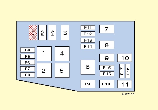

Гледам аз и не вярвам на очите си, релето за нафтовата помпа липсва. Имам бушон, но не и реле
Ето позициите на бушоните и релетата в двигателния отсек. Реле No 8 липсва...
F1 (80A) – Main power supply to fascia fuse box
F2 (60A) – Engine coolant blower motors
F3 (80A) – Glow plug relay, ABS control module
F4 (20A) – Ignition control module, engine control module, glow plug relay
F5 (30A) – Heated windscreen – left
F6 (30A) – Heated windscreen - right
F7 (30A) – ABS control module
F8 (30A) – Dim dip relay, seat heater relay
F9 (20A) – Engine control module, cold start timing advance relay
F10 (20A) – ignition switch
F11 (3A) – Engine control module
F12 (15A) – Horn relay, indicators
F13 (15A) – Oxygen sensor
F14 (15A) – Fuel pump, engine control module
F15 (10A) – Headlamp low beam - right
F16 (10A) – Headlamp low beam - left
F17 (10A) – Headlamp high beam - right
F18 (10A) – Headlamp high beam – left
1 – Headlamp dim-dip relay (green)
2 – Engine coolant blower motor relay 2 (black)
3 – Air conditioning compressor clutch relay – petrol (blue)
4 – Heated windscreen timer relay (yellow)
5 – Engine coolant blower motor 1 (dark green)
6 – Starter motor relay (yellow)
7 – Horn relay (brown)
8 – Fuel pump relay (brown)
9 – Headlamp low beam relay (white)
10 - Headlamp high beam relay (white)
11 – Engine control module relay
Моля колегите с дизелови мондеота да кажат дали имат реле на това място, но се съмнявам да няма фабрично...
Благодаря.
