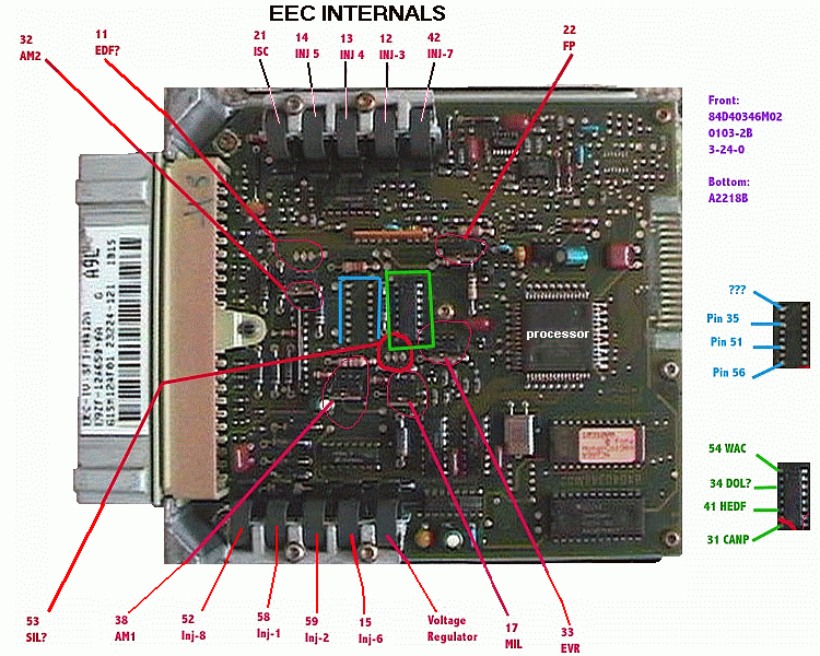

Код: Избери всички
The internals of EEC are complex; Intel and Ford had a joint venture building EEC. EEC uses a custom Intel 8061 chip for its processing functions. This chip is modified only for EEC and is soldiered into the computer board. This 8061 processor chip holds the factory fuel injection program and commands the rest of the internal components. There is also a custom Intel 8361 memory chip. The EEC has three different kinds of memory, ROM KAM & RAM. Read Only Memory or ROM; this is the long-term memory where the master program is kept. The ROM cannot be altered and lasts 20 years after the EEC is disconnected from voltage. Keep-Alive Memory or KAM; this is the complex mid term memory; this memory lasts for as long as EEC is receiving 12 volts. The KAM is where the trouble codes are stored, and where the sensor baselines are memorized. Random Access Memory or RAM is the short-term memory; this is where data is stored during a trip. Once the key is turn off the RAM is deleted....
